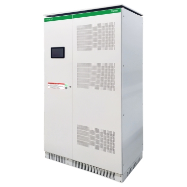

Ascertaining the level of "Operational impact" from voltage events (regardless of their origin) facilitates easier prioritizing and filtering metering system alarms, creating and trending historical effects from disruptive perturbations, and determining locations and sizes of mitigation equipment like Schneider Electric’s PowerLogic Dynamic Voltage Restorer ( DVR), is the "Key" to resolving a client's PQ Challenge.
Discover more about PowerLogic DVR HERE
