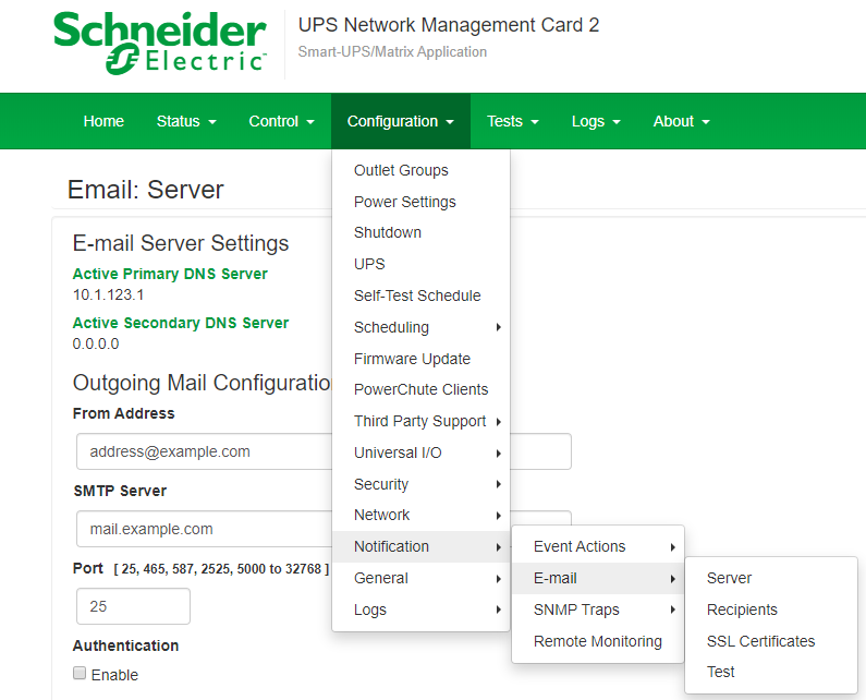

In the Notifications section I see you can send SMTP mails when a alert is triggered. Is there a way to send a alert using a HTTP POST request or Web Request?

There is no built in option however, PowerChute provides the option to run command file / script when an event occurs. You could write a command file / script that would send the notification you require.
I ran a web search "command file to send http post" and found many entries that offer assistance with writing the command file / scripting.
