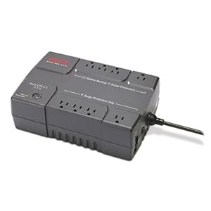

Update - I think BE350R is the battery id. I can't find any ID for the UPS except ES 350 on the top, no suffix. It looks like this one: http://ecx.images-amazon.com/images/I/4116BZEHEKL._SL500_AA300_.jpg
